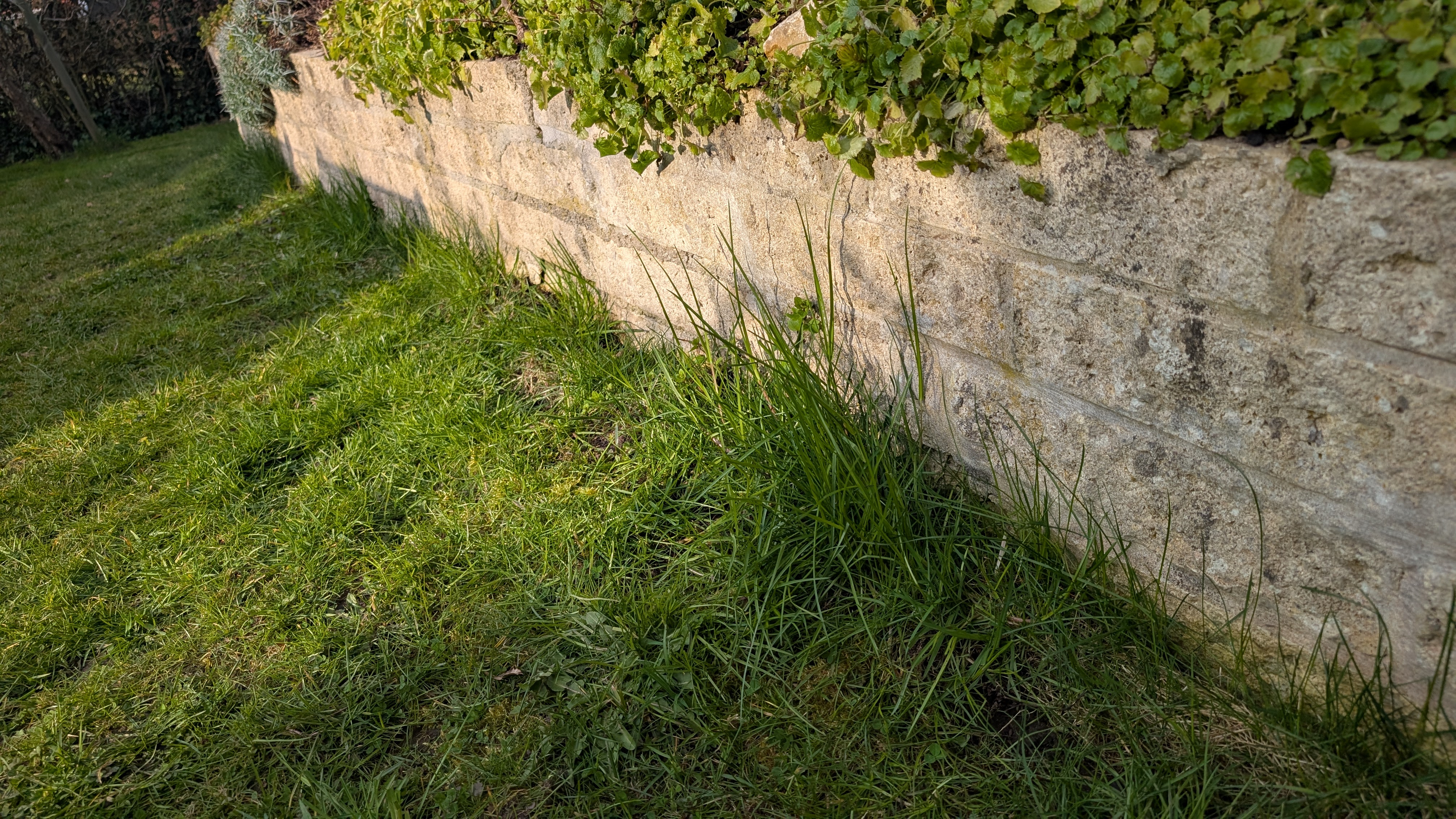

I drove right next to the wall when creating the map. I also deactivated the safe edge cut option, activated UltraTrim 2.0 and set the object avoidance to the lowest setting. Nevertheless, the mower keeps a giant distance from the wall. Shouldn't it cut up until 3 cm? This are more than 13 cm.
What else can I do to fix this?

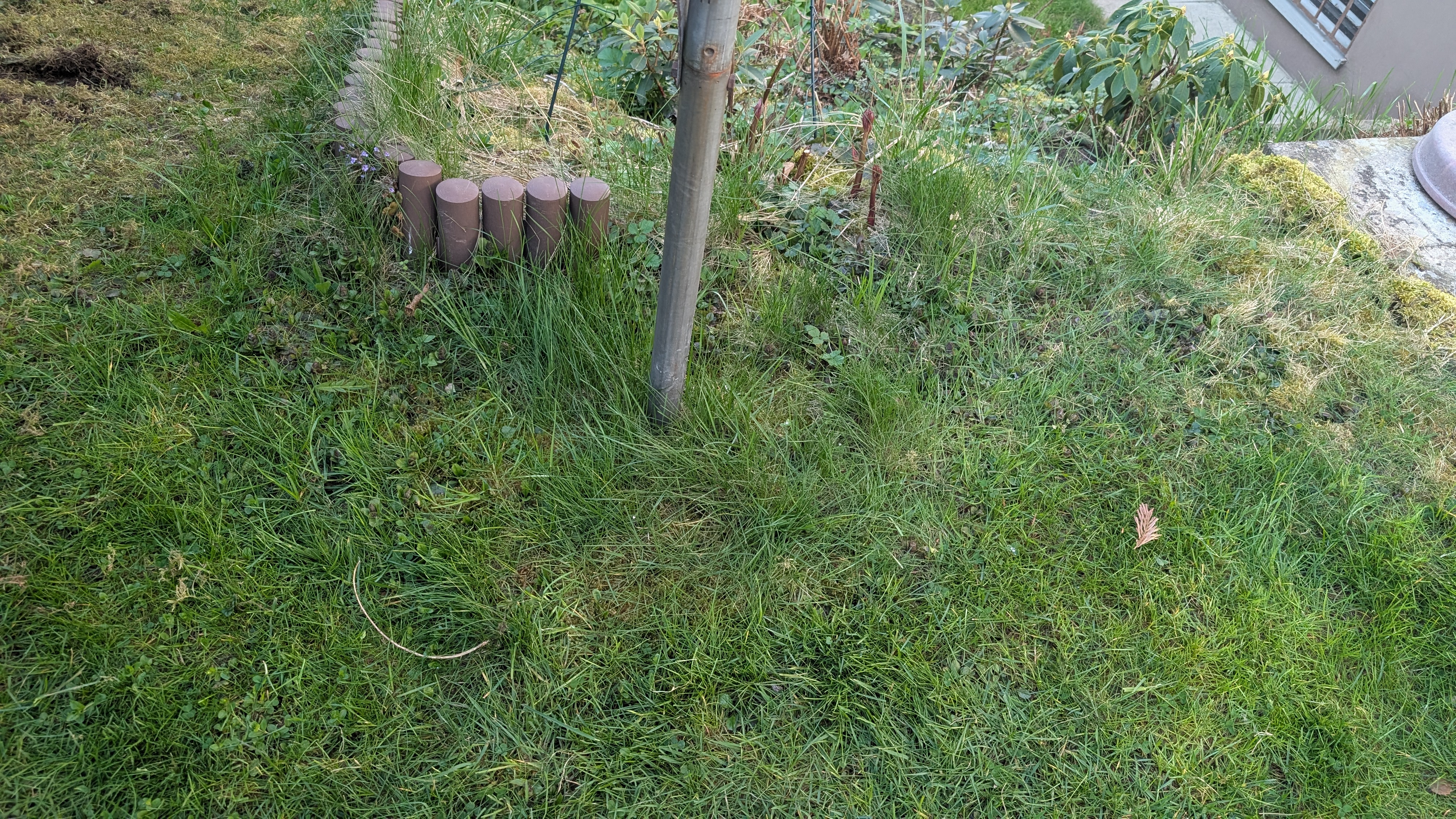

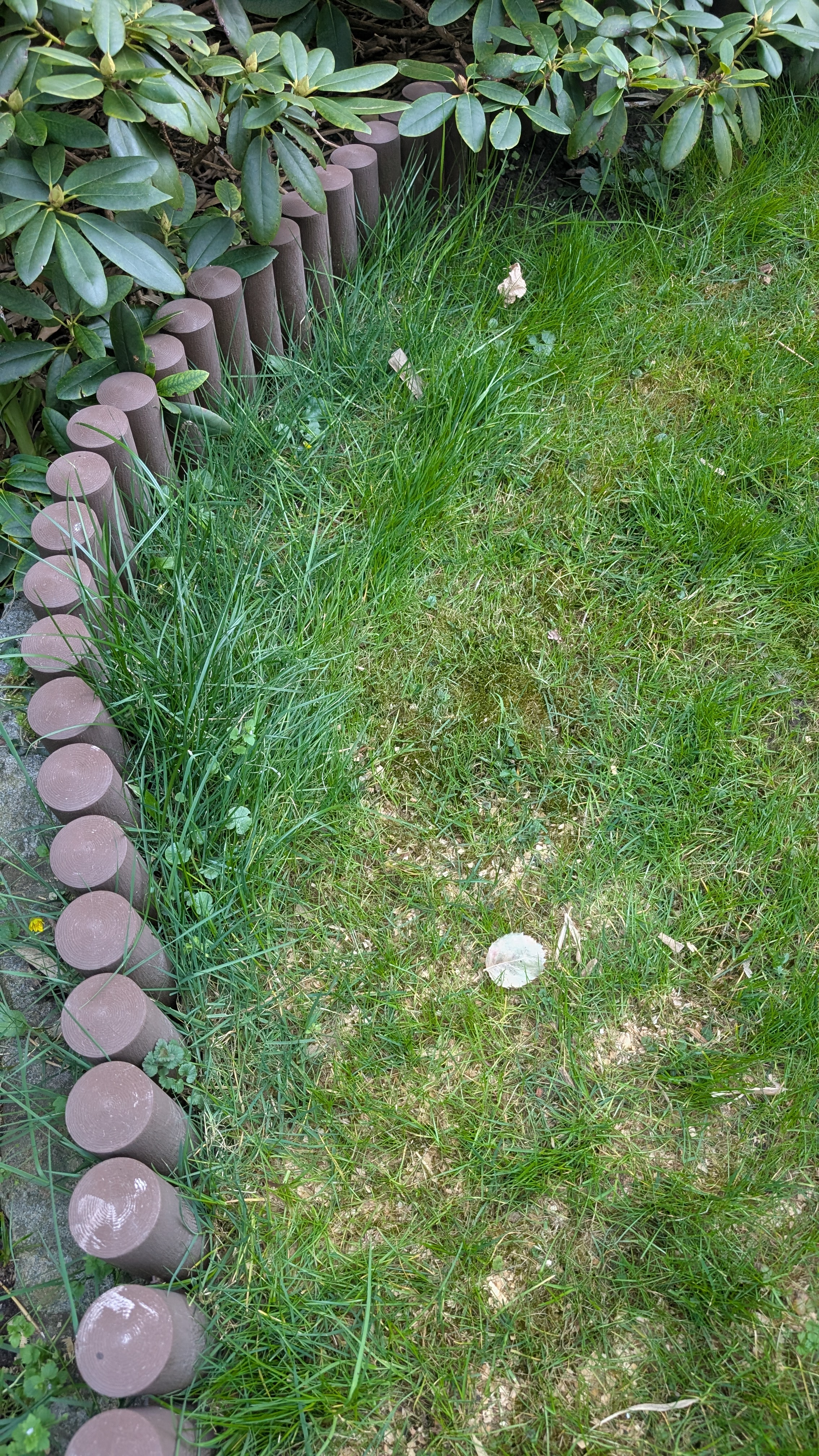

Bei gekrümmten Rändern ist es noch übler.
SpyroThemenstarter

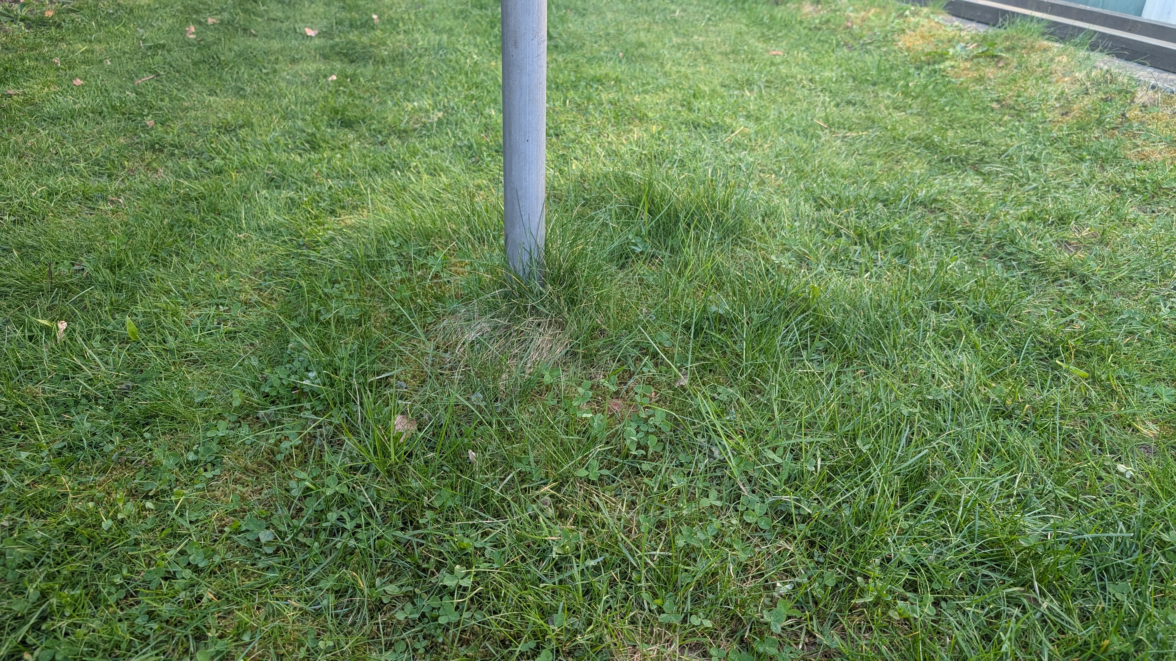

Auch an Stangen traut er sich nicht ran.

Auch hier, eigentlich minimaler Anstand eingestellt.

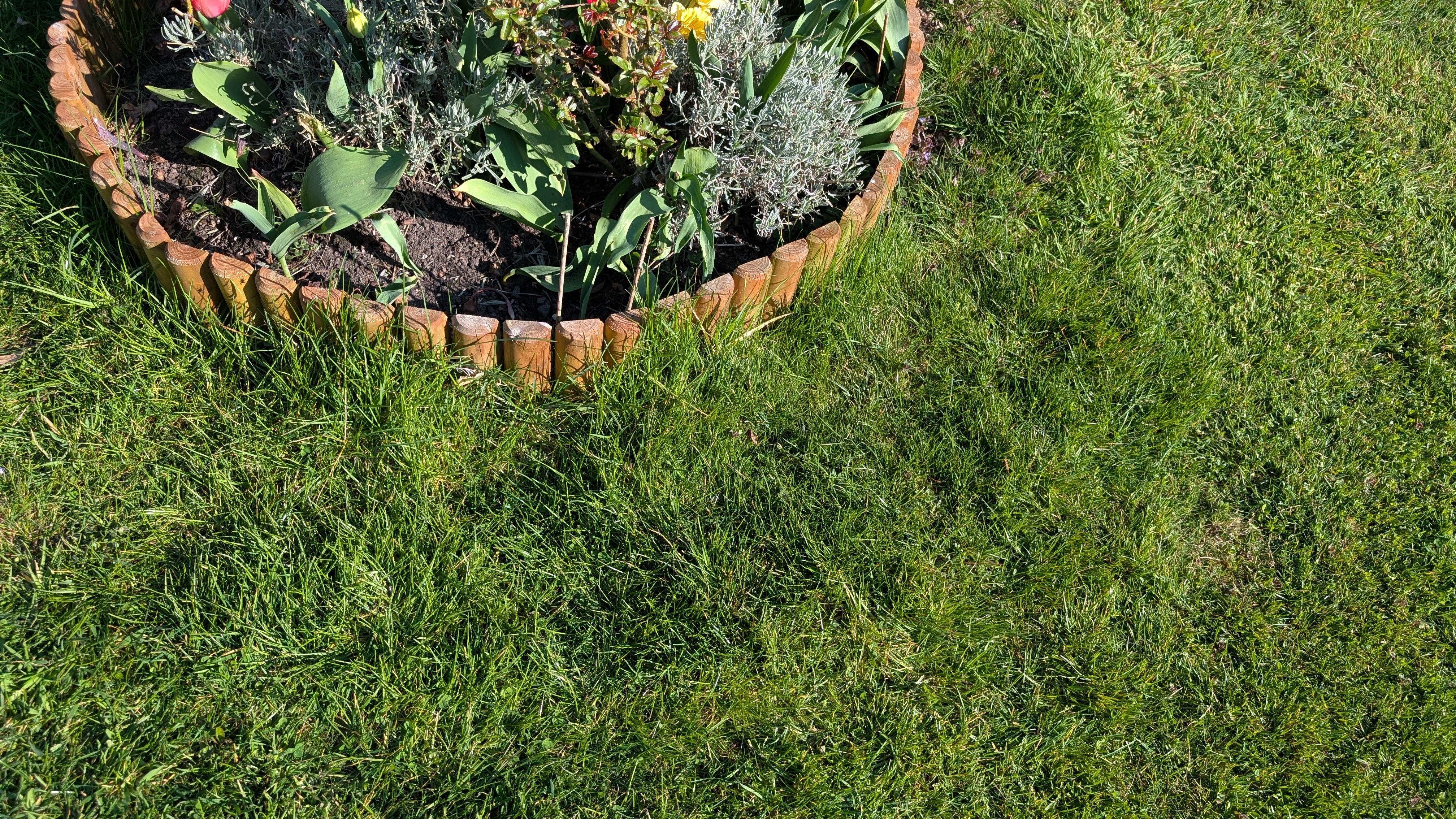

Selbes Problem mit Kreisen. Soviel zum Thema "Ultra Trim 2.0"
