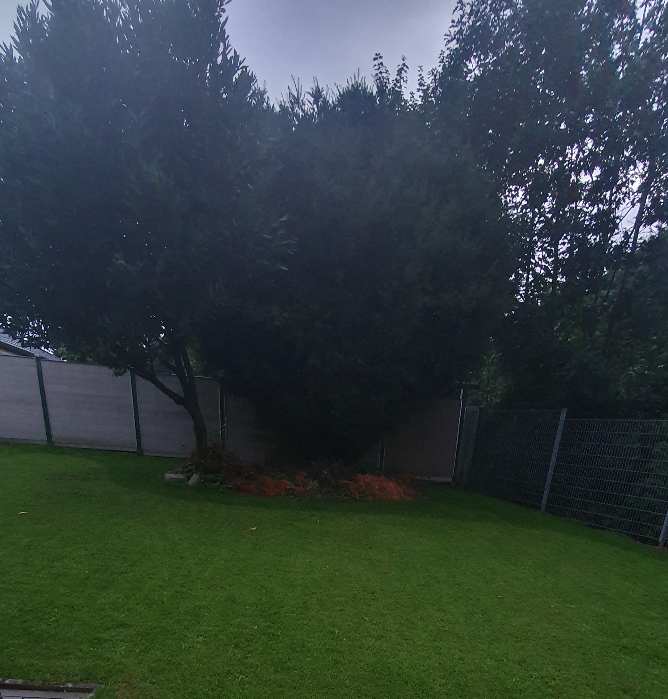

Hello,
I would like to mow my grass at different heights.
The outline of the area at 6 cm forming a 1,5m wide "frame" around the "infield", which is 4 cm.
The frame merges with the infield, when i tried to use 2 zones in one map without a gap between the 2.
I could use two maps, but that it is not efficient, as 80% of the time its mowing at 6cm cutting height over 4cm tall grass.
Has anyone found a solution, is there a feature in the app that i missed?
