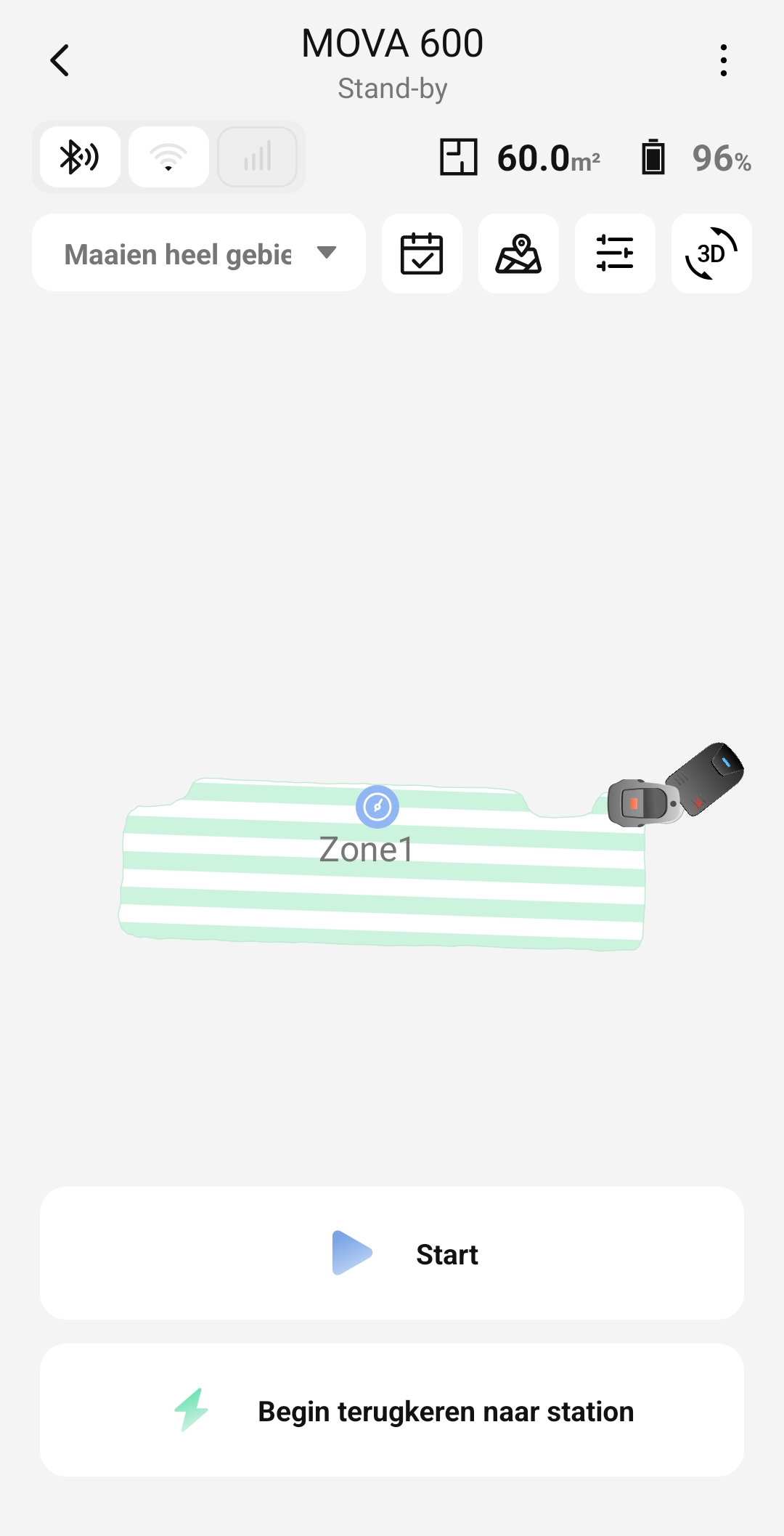

After mapping de loading station is in the wrong spot on the map.
So after mowing the robot cannot find the loading station.
I did a factory reset and power off the mower and loading station but nothing helps.
After every mapping sequence the loading station is in the wrong spot on the map.

Hello,
If the base station is moved significantly while the MOVA 600 is operating, the MOVA 600 will fail to locate and will be unable to recharge.
You can manually move the MOVA 600 or remotely control it back to the base. The MOVA 600 will automatically update the base station's location the next time it leaves the base station and starts a mission.
If you have moved the base station outside the operating area, you can set a channel in "Channel Settings" under "Map Edit" to connect the base station to the operating area.
Jonaev
I did al the things you mentioned. I created a path to the station. The station is just outside the zone.
One week he did it right. After that week de station was always on the wrong spot.
Even when i deleted the map and created a new one.
After a session i put the mower manually on the station, the location changes but is still wrong.
I don't know what to do.
