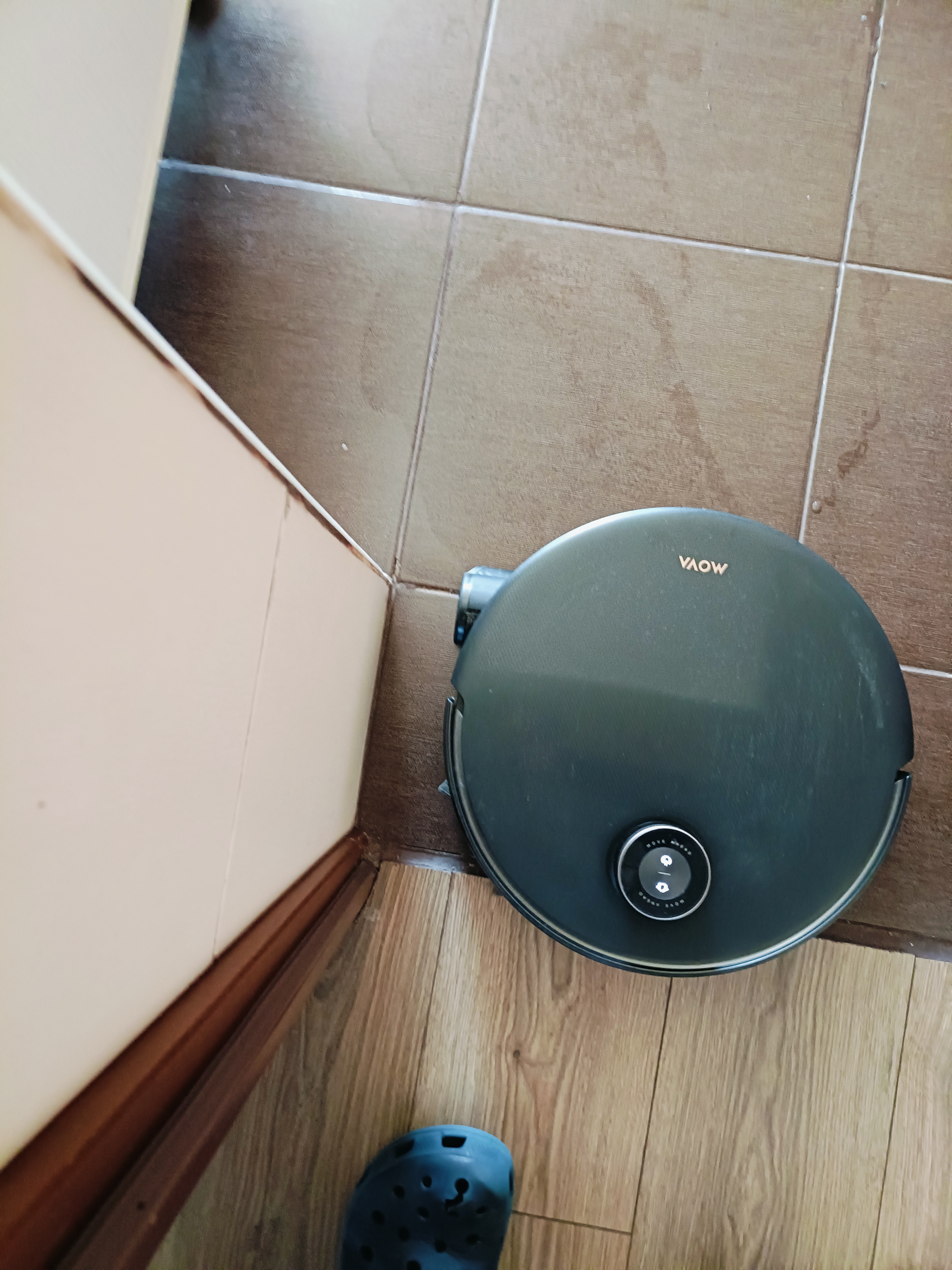

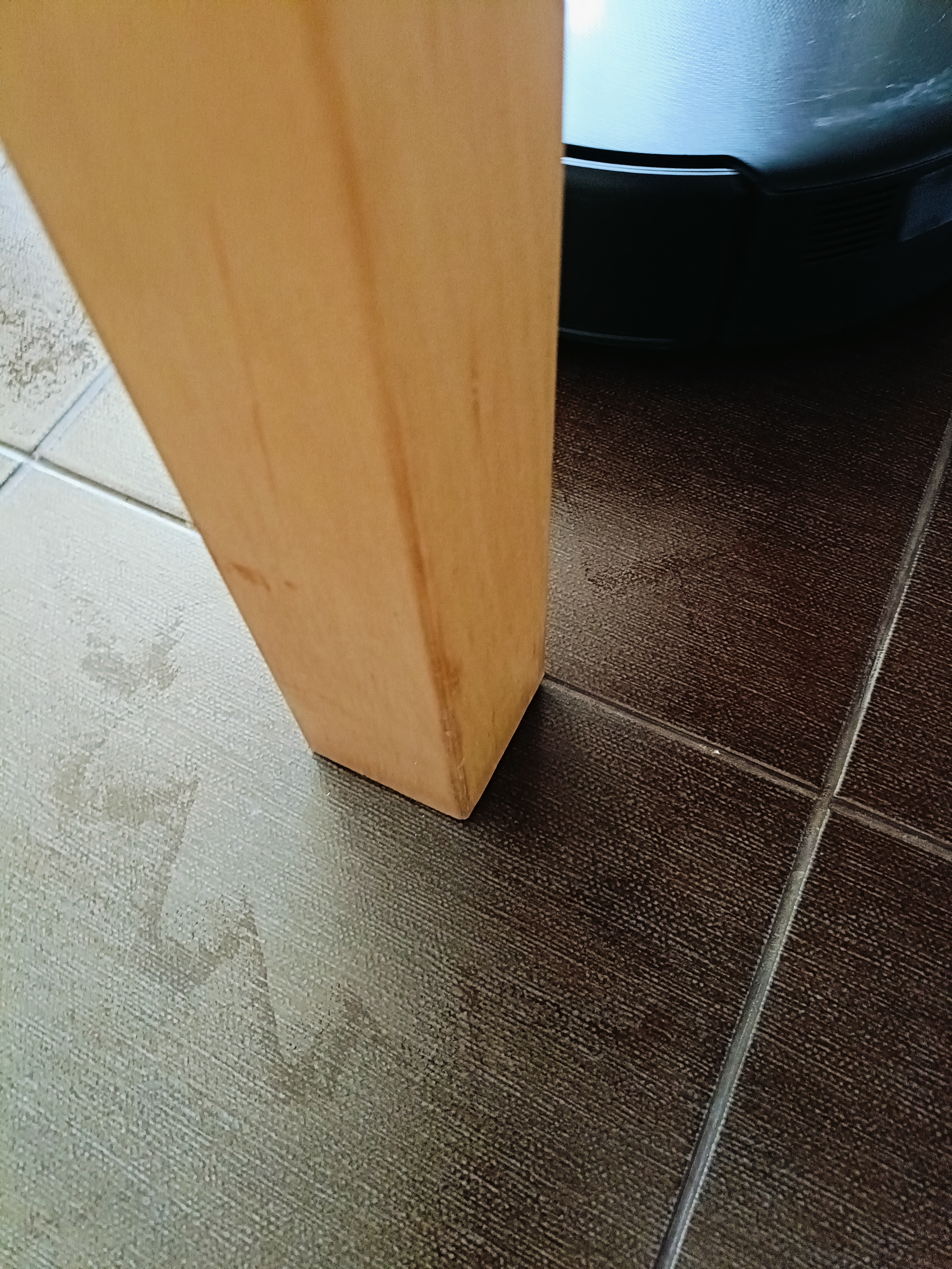

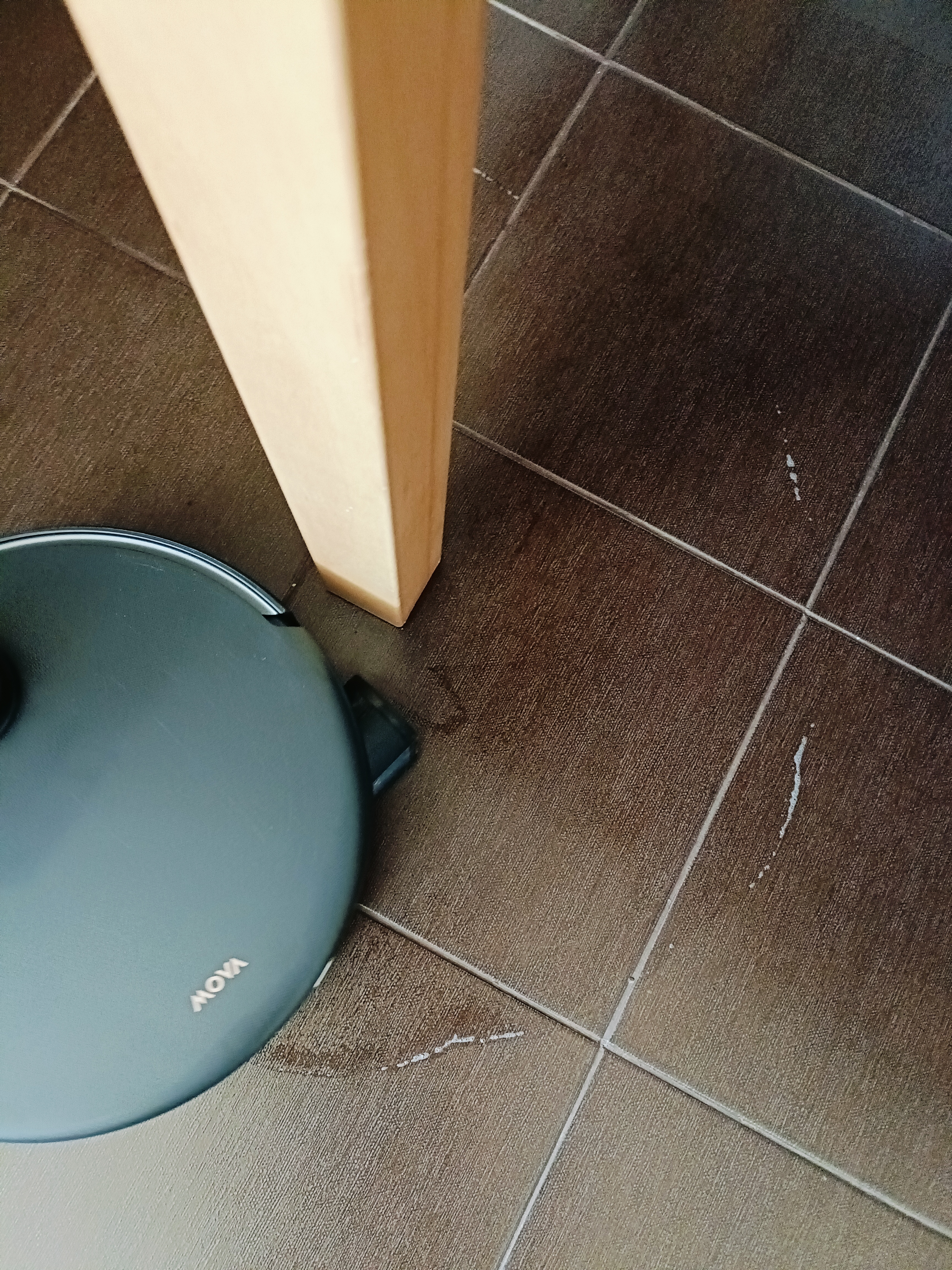

As you can see from the attached picture, the robot does not clean within 1cm of the table legs and sometimes even the wall, leaving a fairly large space, around 5cm. How can this be solved?
PS. I have reset it, i rescan the floors,i have the last firmware 4.3.9_3454.

Hello,
Regarding this issue, please wipe the edge sensor on the right side of the robot with a soft, dry cloth. Ensure the edge sensor is not obstructed by any obstacles/objects.
Then turn off the anti-collision mode and see if the situation improves.
Go to the three dots in the upper right corner – Floor Cleaning Settings – Collision-avoidance mode
Also, please set the mop's outward spread frequency to "High Frequency".
If the device still cannot clean along the edges, please contact our after-sales department for further assistance.
2026-3-13 04:58:58 GB Translate
Tks,it s working.
2026-3-17 15:47 GB Translate
