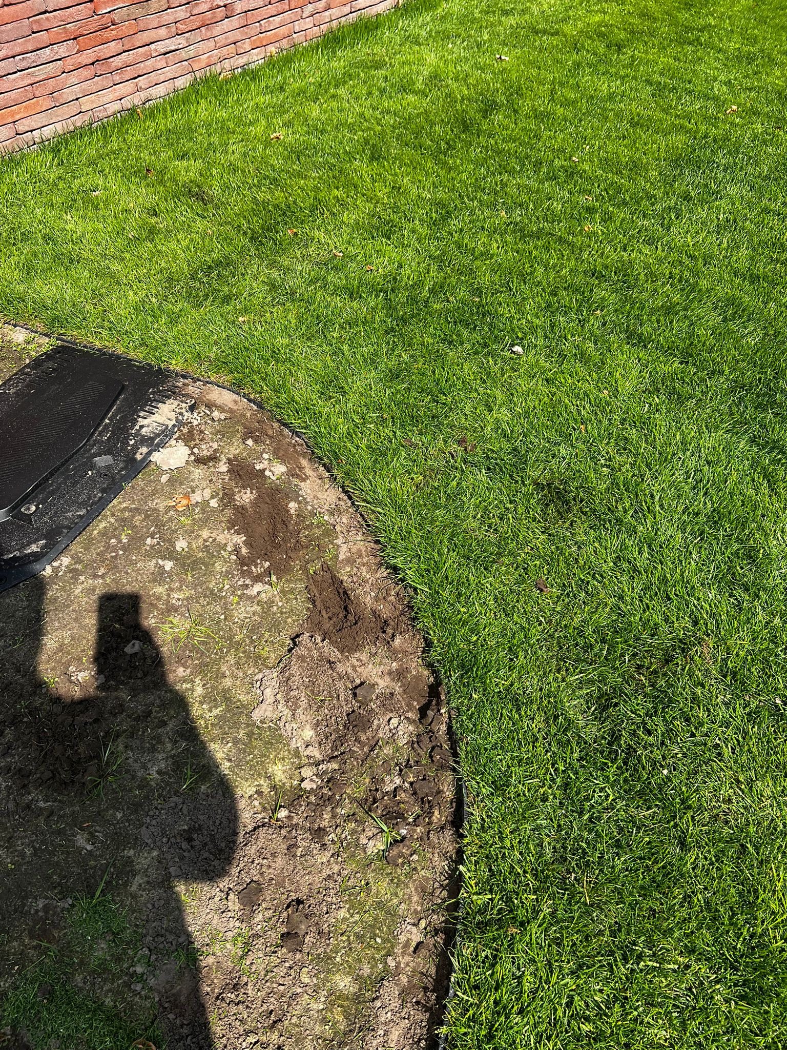

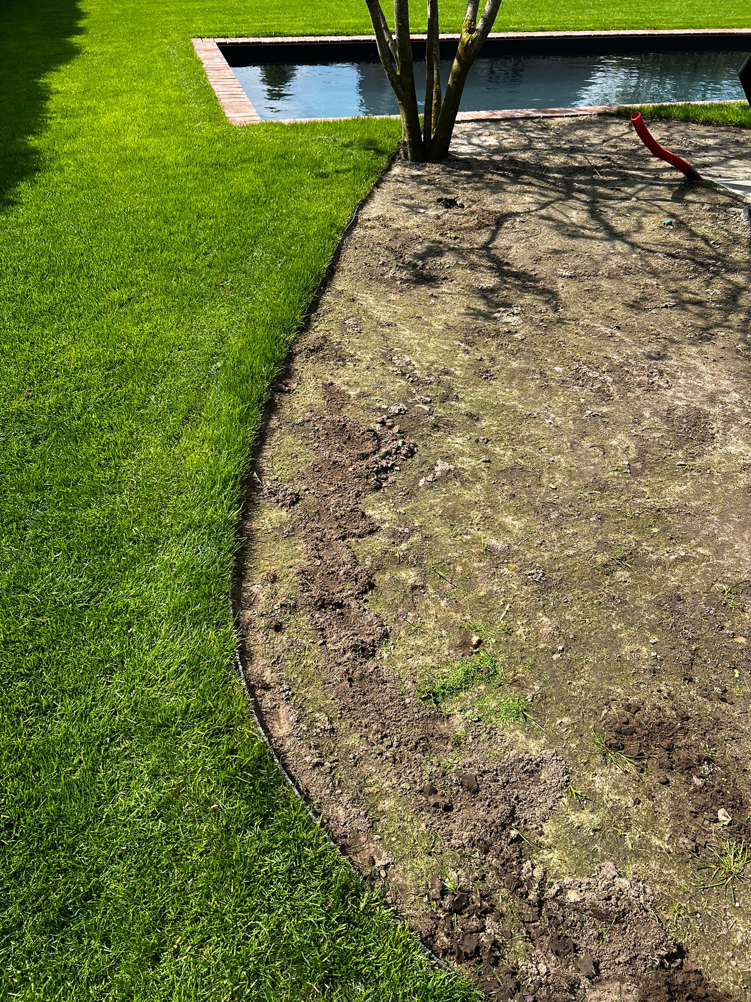

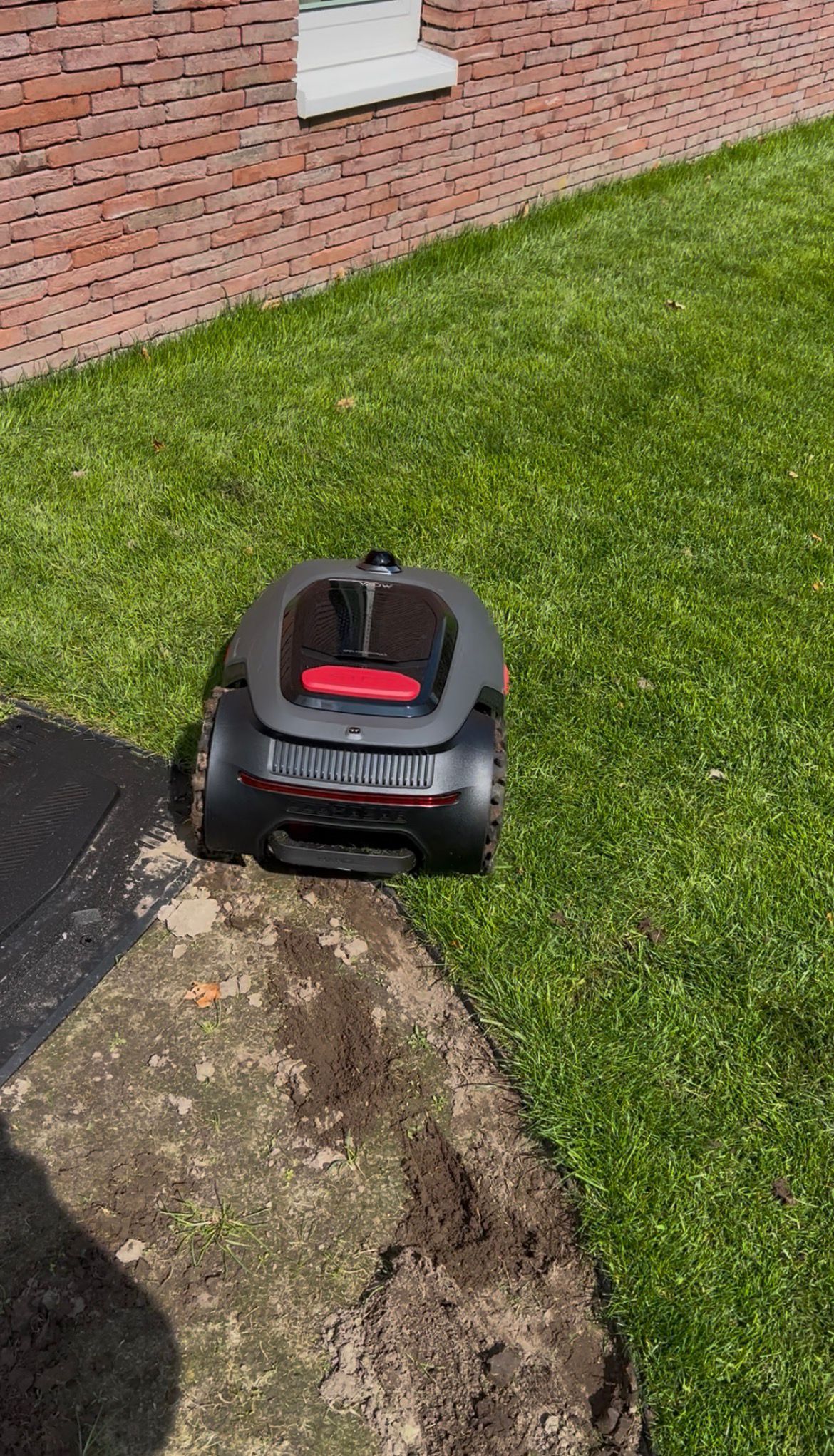

- Garden: Flat, new sod, curved borders with Ecolat edges (flush with grass, but soil level inside the border is currently 5cm lower).
- Mapping: Manual mapping performed by walking the perimeter.
- Settings: Height 4.5cm, UltraTrim 1.0 ON (3cm is a bit too short for my liking), Obstacle avoidance at 10cm, AI detection ON, Lidar obstacle detection OFF (to manage overhanging hedges).
The issues:
Although the Ecolat is flush with the grass, the mower often drifts 1 or 2 wheels over the edge into the border (5cm drop). It struggles to get back out, leading to "mower stuck" alerts even if it eventually escapes. The "mower stuck" error appears when it's driven 1-2m once it got out of the border.

- What is the best way to map "cliff-like" borders (5cm drop) to prevent wheels from falling in? The user guide mentioned to take a bit more distance while mapping when there's an edge with 10cm difference.
Attached some photo's showing the tracks when it got stuck to give you an idea of the situation. It's the same across the whole garden.
