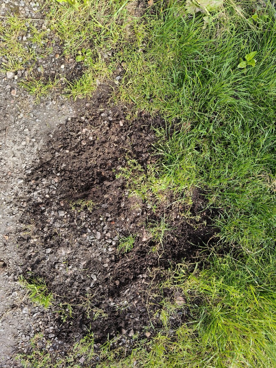

Has MOVA figured - how to prevent digging?
The most challenge place is just outside of charging base.
It has already dig about 5cm deep in this year.
MOVA uses too much power while turning.
Those cases needs to run as with a car on ice - smoothly.
3 Comment
The mower will always do there '360degrees digging'
before start to mow as well as almost every time before start to recharge.
Isn't that place fixed ... cannot change ... or how?
... or it could change be moving a charging base weekly.
Your give 'Navigation Path' work only with paths or how?
Paths are not challenges with my mower - all turnings are.
My image is that the mover use too much power while turning.
Basically same kind of case could be in every 180degree turn, especially with very challenge places.
... needs to run as with a car on ice - smoothly
Have Mova Support ever drive a car or even walk on icy road? Please, try to find videos.
If a car stops on icy road and You'll use full power - a car won't move.
Same case will be on law - too much power - it will only dig it.
Instead of start to move smoothly and if nothing won't happen - try to change direction.
You asked: times, photos, videos, places.
There are too many times and places - should I report from 50% of turns.
My map is now 730m2. I split it with eight zones, because I cannot mow the whole area in same day.
Nowadays, mowing is possible be from 15 to 19. It depends of moisture of lawn (no rain).
I've MOVA 1000 with Your the latest firmware which You've updated.
I've already tried to report same case 2025-7-31.
