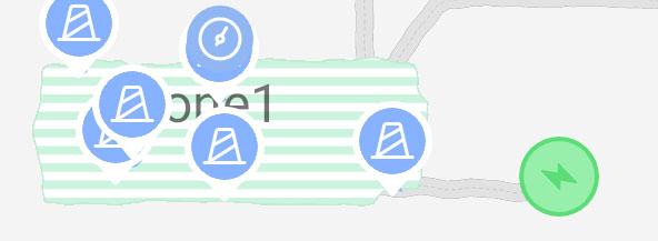

Hi all,
One of the features that convinced me to buy a MOVA 1000 is the possibility to put the docking station outside the garden (i.e., in a sheltered place near a plug).
Here's how to do it:
1) Create a zone
2) Create a path
2a) The starting point of the path must be inside the zone
2b) Drive the robot toward the base station along the desired path. When the robot arrives near the docking station, the app will automatically prompt you to close the path.
3) Finalize the map.
