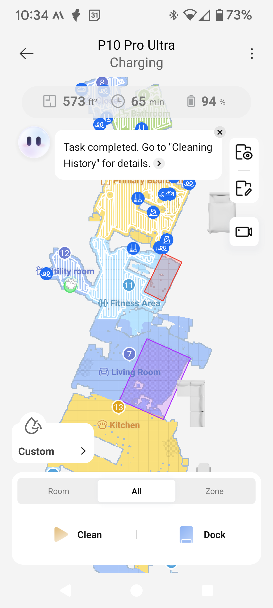

Re-posting but this time with a 2D image.
The map the P10 Pro Ultra created is rotated approximately 30* degrees clockwise. That means I have NO walls that are horizontal or vertical. I've been able to establish no-go zones and a rug since they can be rotated incrementally. Otherwise the map is quite accurate.
But I cannot propertly establish directionality to the wood-tile floor which only rotate in 90* increments.
And I cannot establish any zones - since these only rotate in 90* increments and are thus out of phase with the house map.
I also can't add furniture for the same reason - but I don't think that's very important.
The primary bedroom is about 45* angled from the main part of the house.
The 3D view of the map is a complete mess. It is not accurate at all and I can't even recognize it as the house. But that's OK - as the 2D map is very accurate and works fine (just that it's rotated 30* is all).
See image of 2D map below. Really could use some help on getting this map fixed so I can use features like flooring direction and zones.
