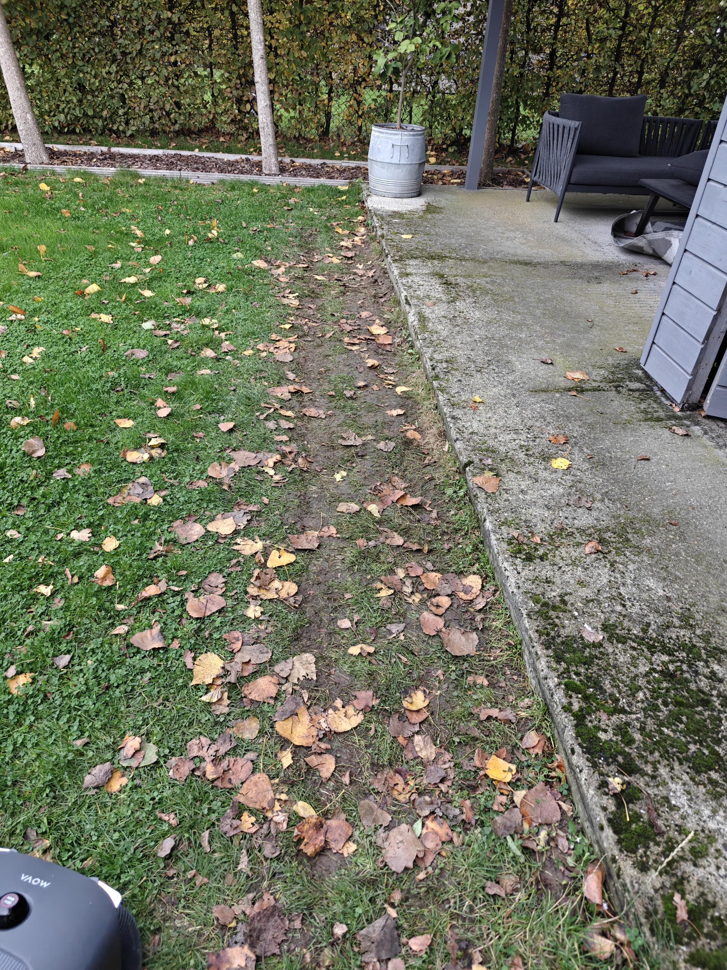

I've just received my Mova 1000 for a week and it is not working properly.
It only mows a small part of lawn and then just starts to ride random against borders or back and forth at a border (which destroyed my lawn after x amount of back and forth...). I constantly get errors like failed to return to station & positioning failed.
I tried to reposition the base and recreated the area for 3 times already but no luck.
Made support ticket 3 days ago but no reply.
Thanks in advance
