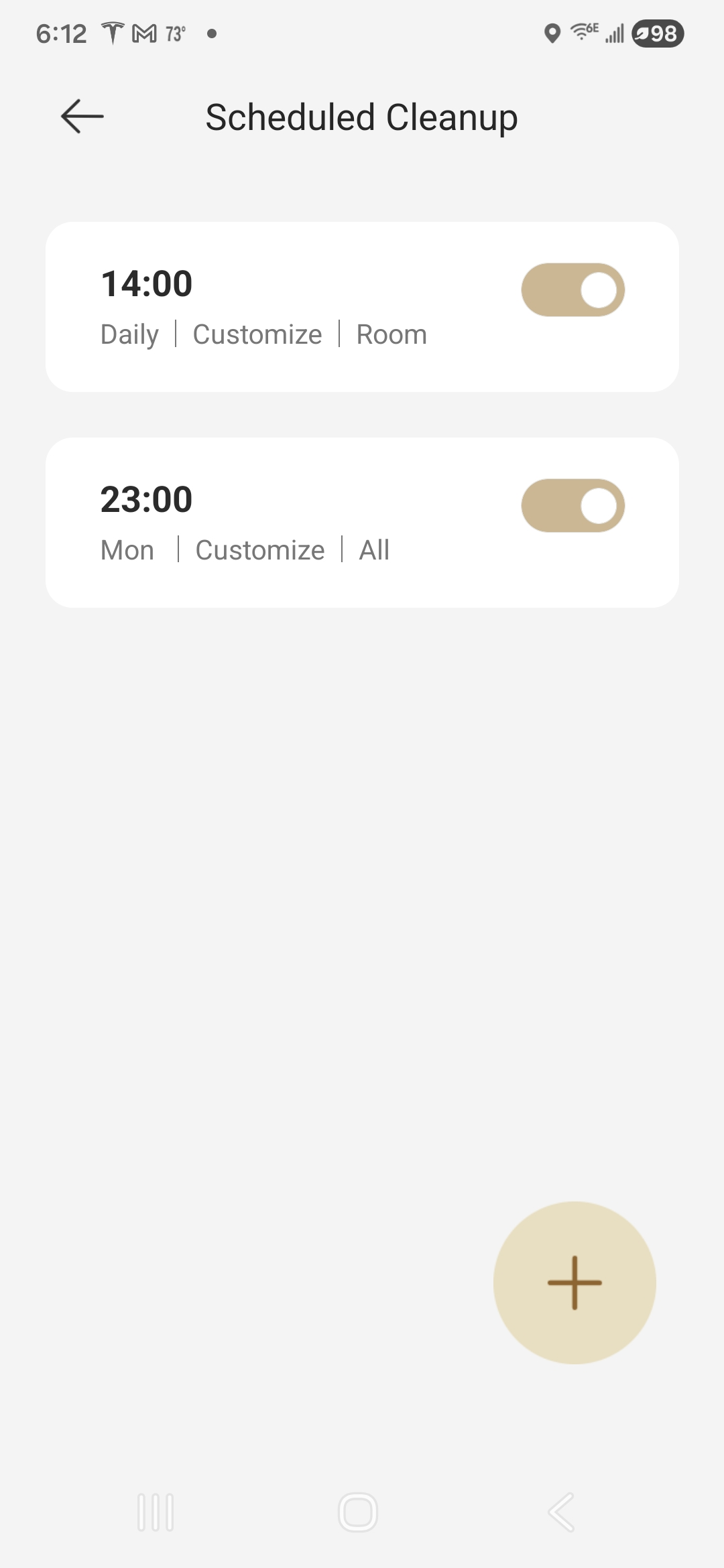

Have a P10 that does its own daily schedule. Used to be 8 pm every night, all rooms. I recently tried to edit, deleting another schedule I had done, added 2 new ones (2 pm daily 2 rooms, and 11 pm all rooms one night only). Today I came home and it was doing all rooms at 10:30 am. I rechecked my listed schedules and only the 2 I mentioned were showing, including on my wife's phone (which is my sign in).

Since November, the backend shows that the scheduled tasks you set have been started normally, and no additional cleaning records apart from the planned cleaning times have been found.

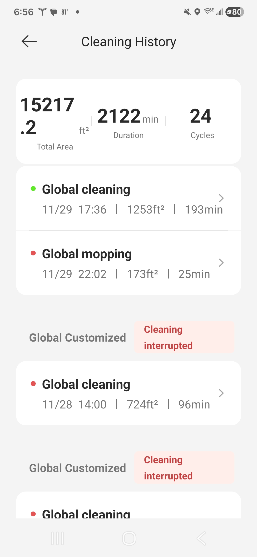

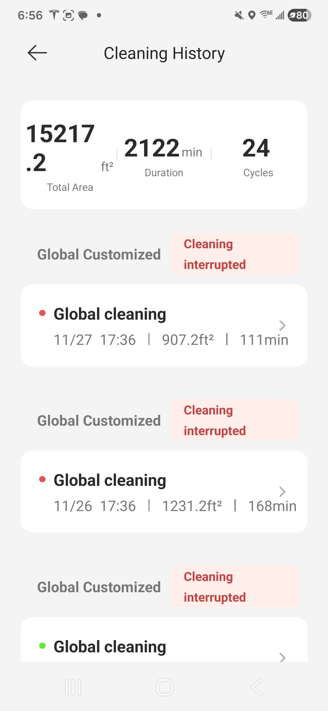

Here are screenshots of the last several cleanings. Only 1400 and 2300 are scheduled. Many labeled interrupted because inconvenient unscheduled starts. Reset how?

I gave it another 2 weeks after resetting the unit. I think it is defective as this has occurred since purchase. I will include the newest logs. After resetting, I made a scheduled cleaning for ONLY 2 pm (1400) on Mon and Fri. As you can see from the cleaning history, yesterday (and today as it started on its own again today), it starts at 17:36, and then did mopping at 22:02, which had to be stopped as we had a guest sleeping over and it wakes them. I'm not sure how it has a 17:36 start each day, which I cannot shut off because it does not appear in the schedule. I think we deserve a new unit. (And I referred a friend to you who just purchased the P50!)

It only let me send one attachment today? - this connects to my previous comment
