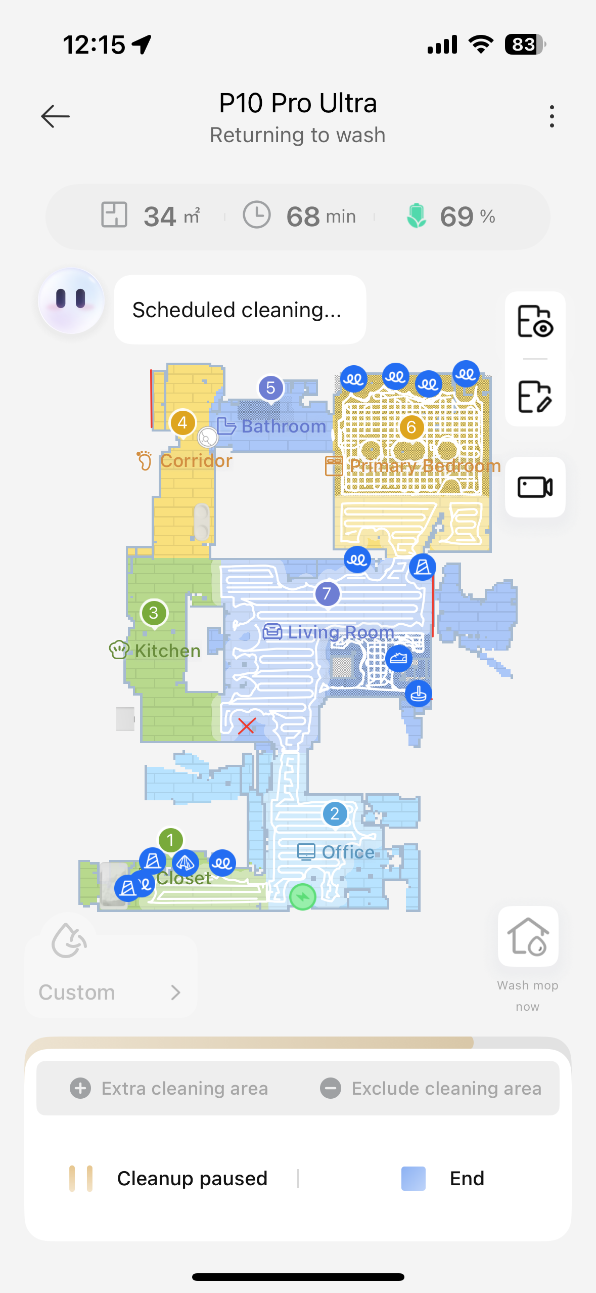

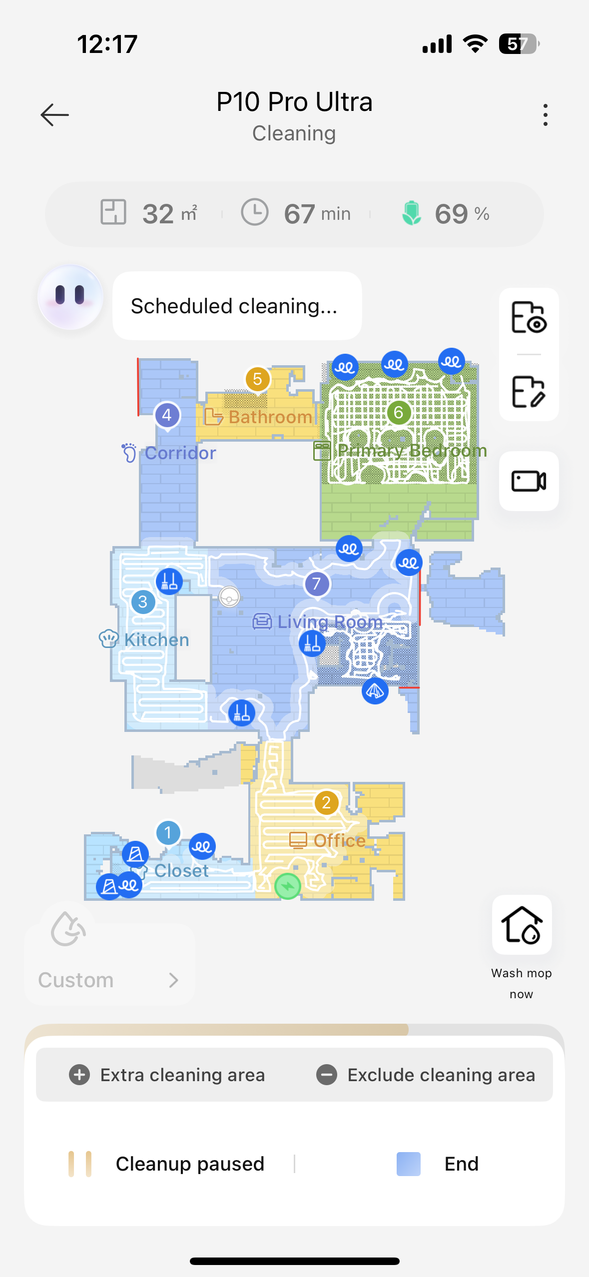

MOVA P10 Pro Ultra doesn’t follow the set room cleaning order in custom mode.
I think it does follow the sequence in CleanGenius, but running it in CleanGenius seems to mean it runs out of water after cleaning about half of a 14 sq. m room and continues to pretend like it’s mopping — with dry pads. (This should also be fixed BTW).
And in Custom it doesn’t follow the room order. Is there a fix for this or do I have to completely remap?
Hello,
For the problem that the robot does not clean the rooms in order. In the selection mode, the robot cleans in the order you click on the rooms.
For the problem that the water runs out quickly and then mops dry, you can set the "Frequency for the returning to self-clean" with the lower area to make the mop being wet enough.
