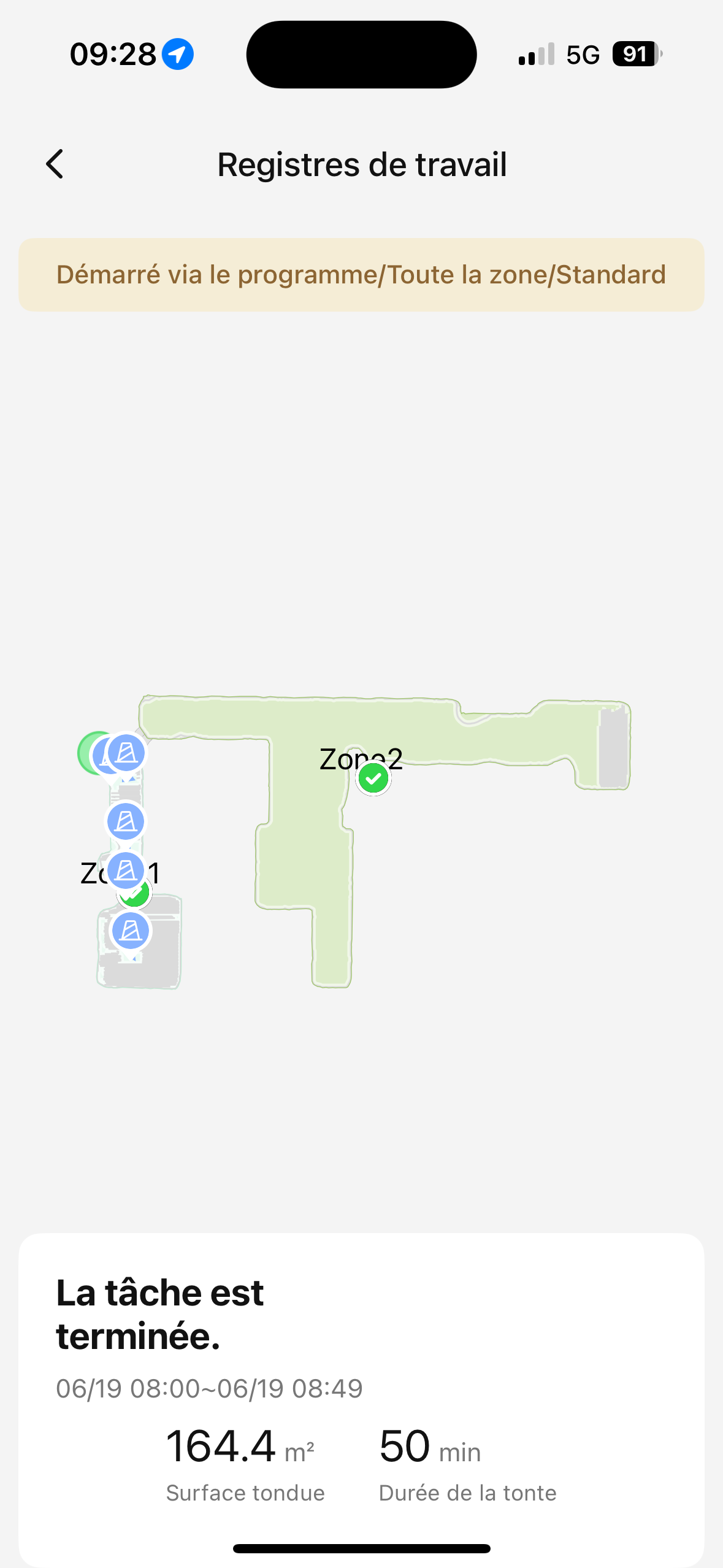

Hello,
It's not the first time I got this, my mova 600 say job it's finished but not. On the image we can see that he says he's done 164m² (the total of both zones), but on the plotter, we can clearly see that he hasn't done everything.
No worries about the schedule; he has 8 hours to do everything.
How it's possible ?
I was thinking of buying a Mova robot vacuum cleaner, but I admit I'm put off by this, it doesn't inspire much confidence with this kind of basic problem...
5 Comment
Hi, just a question: is 164m² a good extimation of you garden area?
Looking at you image, it seems to me that it should be bigger (but I can be wrong).
2025-6-20 12:32:22 Translate
Hello, No it's ok, I see with mova support and he recommands to createone scheduling by zone. I will try this week.
I have the same issue. It sometimes just cuts a couple of minutes (3 minutes for instance on my 80m2 map) and the reports it "finished successfully" and returns to dock. I dont know if it matters but for me it has only done that on scheduled runs.
2025-6-22 10:20:23 Translate
Hello, So it's clairly a bug. I hope mova will release a fix for that.
can't it be because in your zone1 you have a lot of obstacles ? and for the moment i've seen it doesn't handle obstacles very good. for example if you have 2 obstacles aligned with the cutting path, even if there's 2/3m between both, the part between both obstacles won't be done. like if the robot didn't want to go there.
