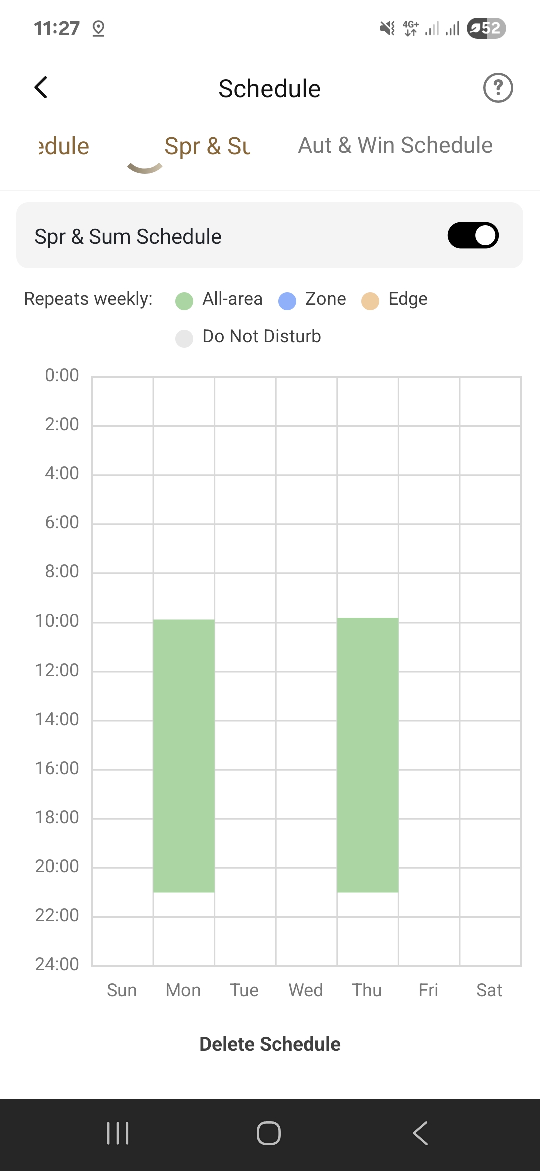

If it starts from schedule, after first recharge it reports as completed (with ~80m2 done) and does not continue. Schedule window is 10hours with full area set.

Hi SY965293,
could you post your scheduling screen (just to be sure that everything is fine)?

SY965293Thread Starter
pretty simple really

Hello,
①MOVA 600/1000 is charging normally. After it is fully charged (95%), it will continue the unfinished task
②Check whether MOVA 600/1000 is currently faulty. If there is a fault, please resolve it first and then continue the task manually
③Please check whether the Do Not Disturb mode is turned on. During the Do Not Disturb time, MOVA 600/1000 will not resume cutting after recharging
④Please check whether the rain protection is turned on. Once water is detected on the radar surface, the protection will be triggered to automatically return to the base station. Wait for 3 hours before re-detecting and continuing to work. You can change the protection duration in the APP, or turn off the rain protection
⑤Please check whether the frost protection is turned on. When the battery is detected to be stable ≤6℃, the frost protection will be triggered. During the frost protection period, the machine cannot be manually triggered to work, and the scheduled tasks will not be executed.
