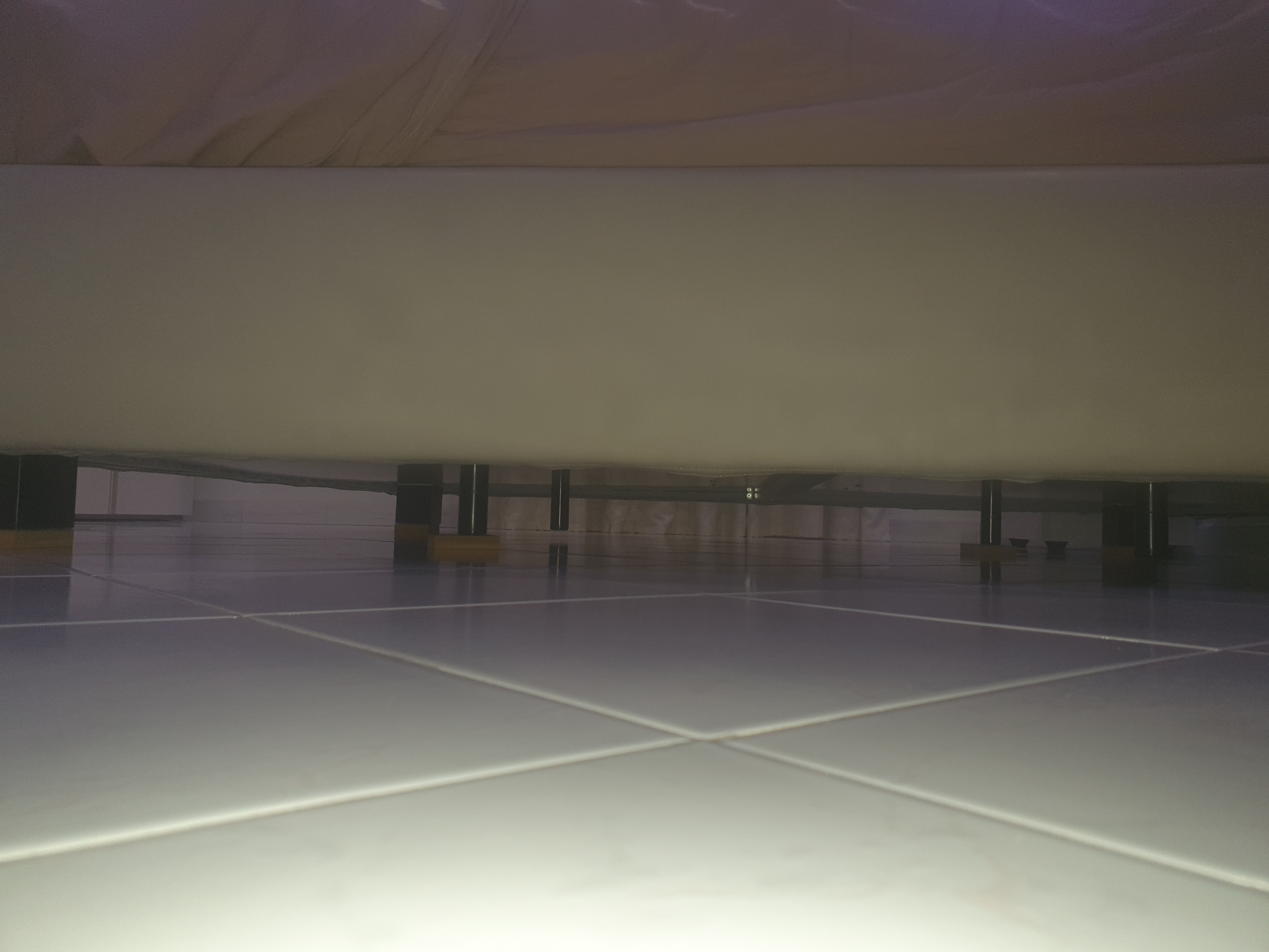

Hello, have you set the area under the bed as a low-altitude zone? Could you update a photo of the area under the bed and also let us know the exact height of the clearance under the bed?

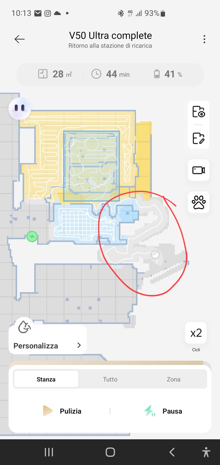

Hi, problem still occurs and is really annoying. The low height zone is more than 9cm. Today the mova was really confused about the path to follow under the bed. The map started again to be overridden and the mova did not lift up the lidar sensor. (I cannot upload mp4 files for video showing since the app does not allow video formats).
I had to restablish the map with the one i backed up previously, stopping the mova activity and then made the robot return to its base without manual intervention.

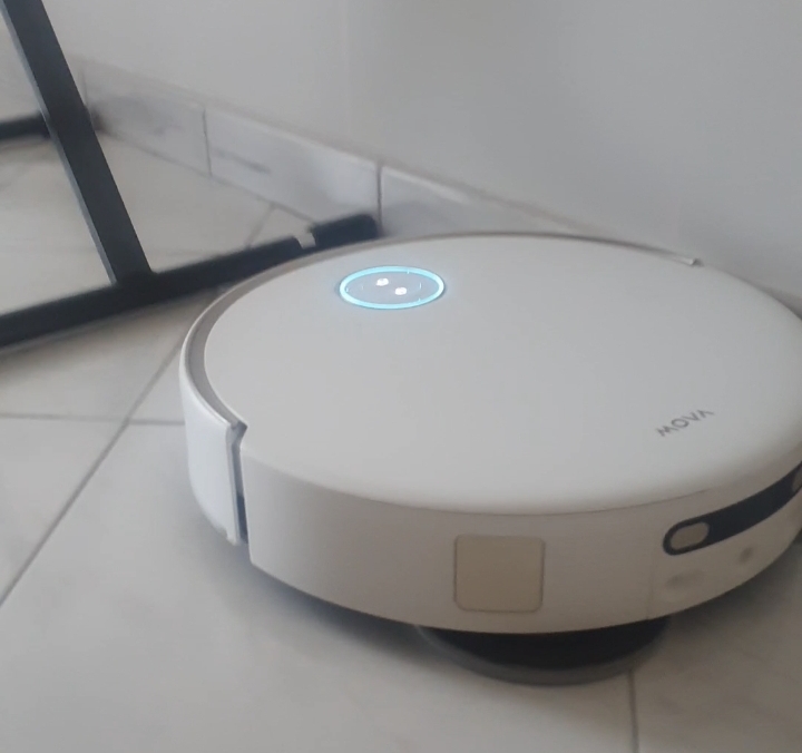

Adding the image to show that lidar sensor is not being lifted up in normal areas AFTER having cleaned under the bed.

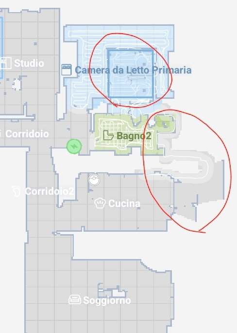

Adding an other image to show you the wrong mapping overridingcthe existent map and to show you how messy is the path the robot follows under the bed.

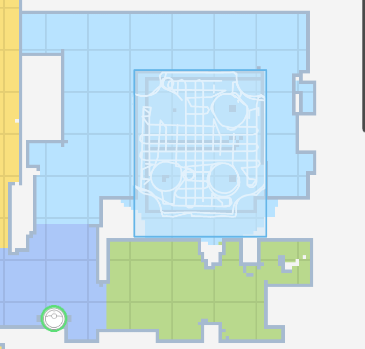

With a second run and after restablishing the backup map this is the path followed by the mova. Though i cannot see the x2 pattern in the low height zone.

As requested, photos of the lpw height zone

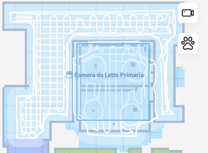

Today i removed the brown bricks under the INNER support legs. The mova usually gets stuck for a while when making circles around them. I will monitor the situation without the brown bricks under the INNER support legs (not the external ones). This is the path followed by the mova after removing them (maybe this is the most correct one)

Today, still wothout the brown bricks under the bed, the path was really confused. May it be because of light reflection on the robot lens? Furthermore. 35sq with 67minutes is a bit too much, isn't it?
