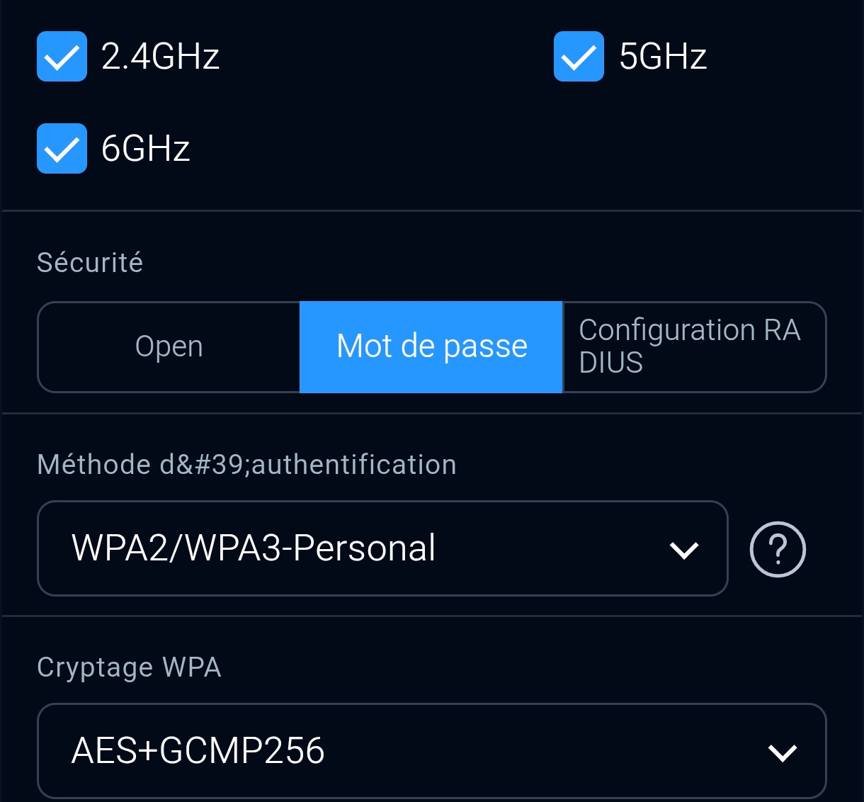

Can ckeck the WPA settings?  Ensure WPA2/WPA3-personal is selected as auth method with AES encryption if any.
Screeshot for educational purpose.
