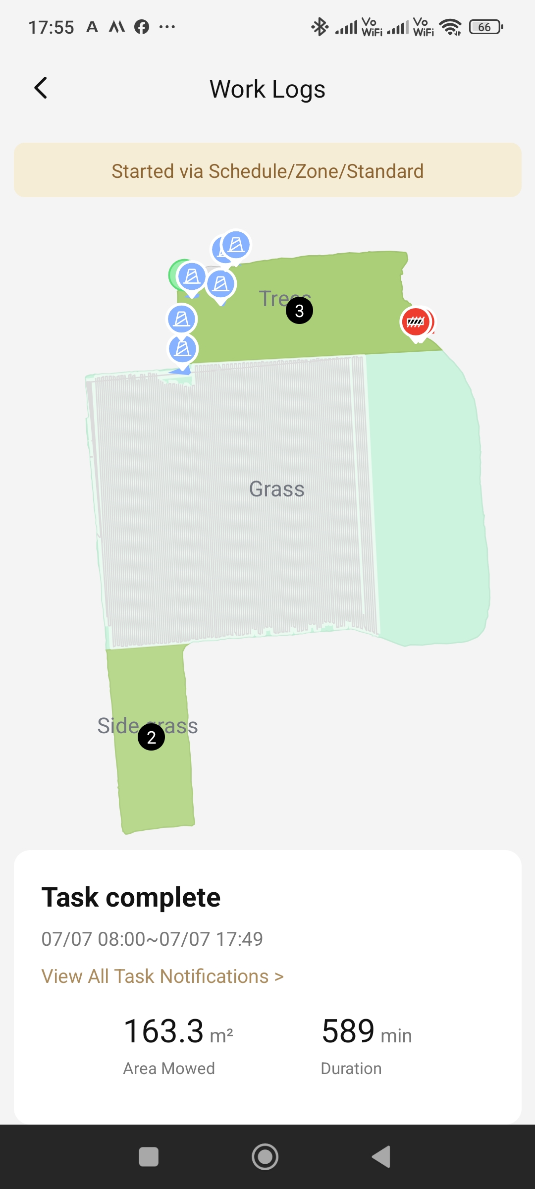

Task completed - not completed
Hi there,
when task started and also started raining I paused the moving and continued after the rain.
Meanwhile time goes off and unfinished task is marked as finished, because of the scheduling range.
It should be not marked as finished.
Pauli
3 Comment
Hello, it’s why I have extended the range of the schedule, even if the application ask to reduce. In my case the work should take a little less than 3 hours,  and I  have set a schedule of 12 hours.
Hi Pauli.
A similar topic is already discussed here
As suggested by NY777542, try to  extended the range of the schedule.
Hello!
If you have turned on the rain protection function, once the radar detects water, it will trigger the rain protection, automatically return to the base station and end the task. You can change the rain protection time in the APP, or turn off the rain protection function.
