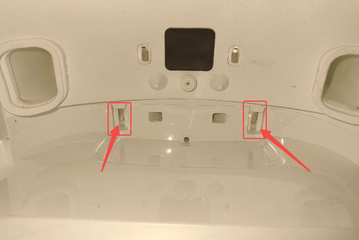

Mova p10 error in water level for the washboard
Have tried everything online, the water tank is properly inserted, closed tightly, tried filling unclean tank with some water, pushing It down firmly. Cleaned the washing area too to ensure no obstacle. First day of using it, can I please get some help
Hello,
Abnormal water levels on the washboard are closely related to the seal of the dirty water tank. You can check whether the dirty water tank cap is securely fastened and whether the seal is abnormal.
You can also check the drain outlet on the washboard for blockage and clean it promptly. Also, clean the overflow sensor on the washboard (see attached picture).
If the problem persists, you may contact the seller or our after-sales department for further assistance.
