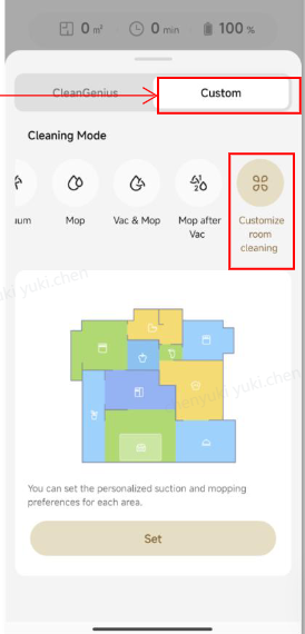

Is it possible to select different cleaning modes for each room?
For example, in the kitchen, I wash and vacuum with one suction and humidity level, in the bathroom, I wash and vacuum with different suction and humidity levels, and in the room, only vacuuming.
I look forward to your feedback.

Hello,
Tap on the "Custom" mode, then scroll to the last option under cleaning modes: "Customize room cleaning."
Once you open the "Customize room cleaning" feature, you’ll be able to set different cleaning modes for each room.
