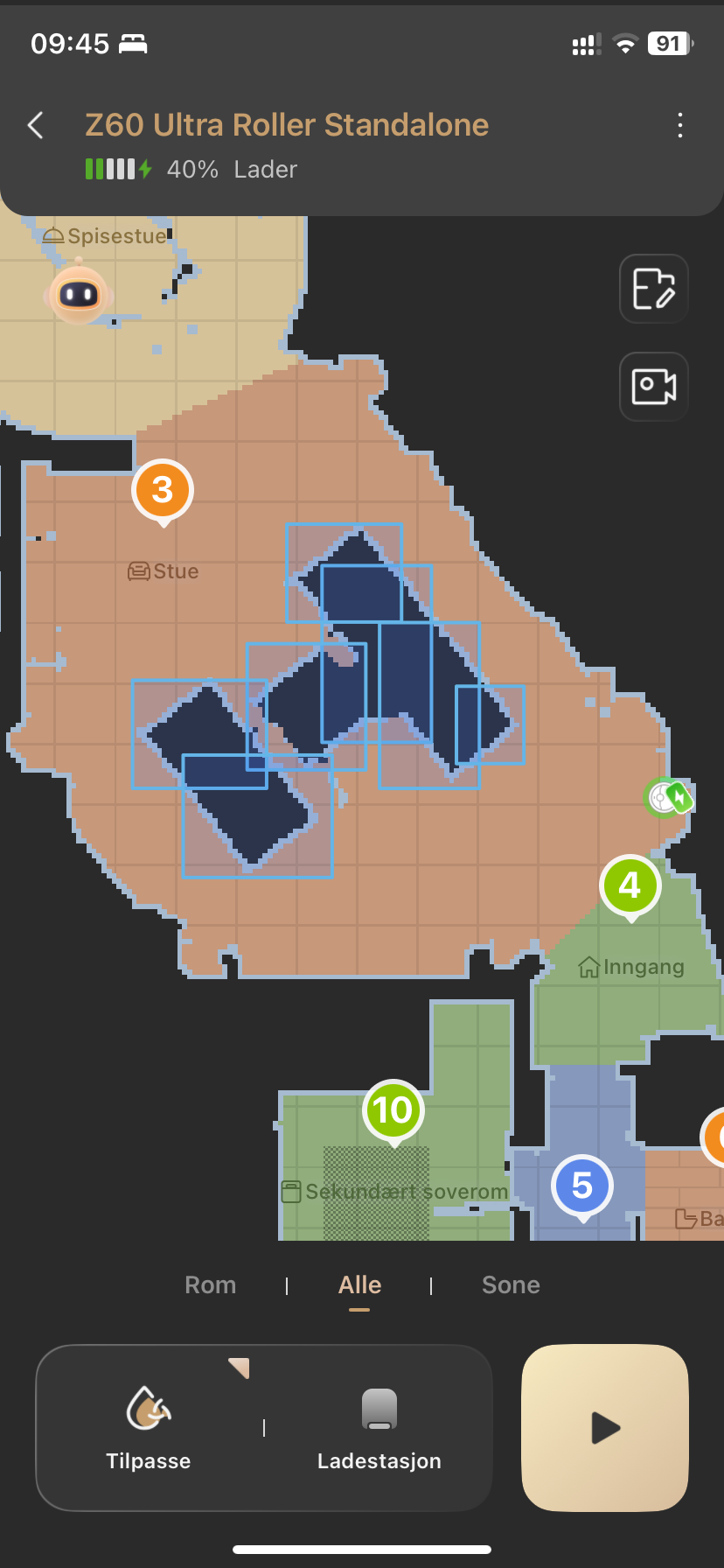

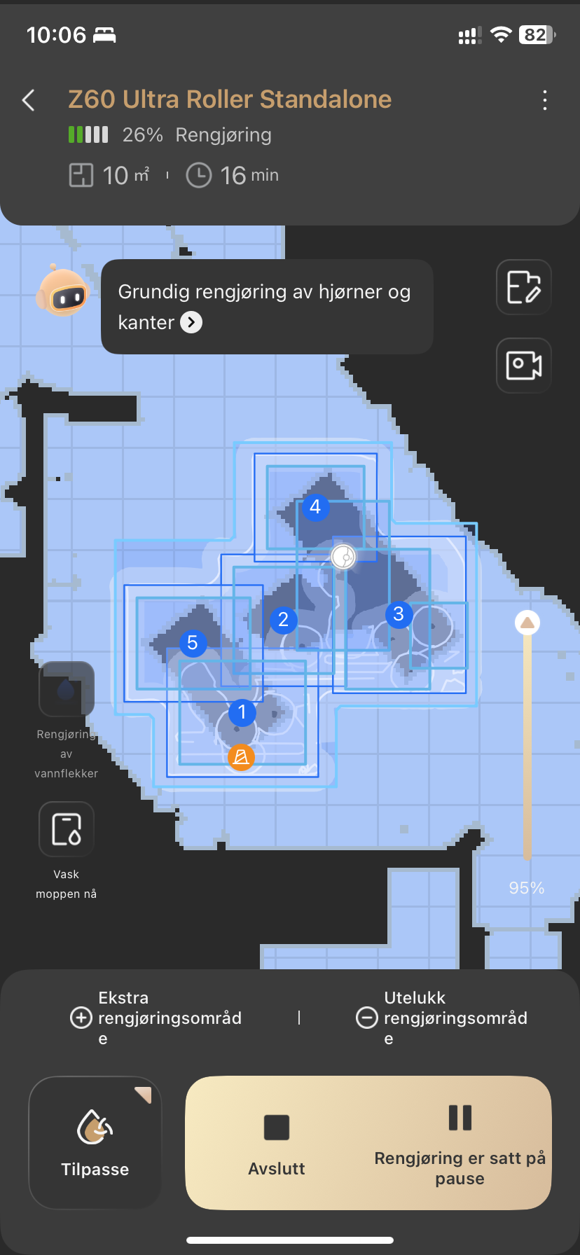

Annoying trying to get the Z60 ultra roller to clean under my couch.. it does not like going under it even though it is 11cm clearing. So I’d have to mark up the «low clearing» myself. With  limited rotation of the zones this is not optimal at all. After manual zoning The robot does clean under my furniture.
