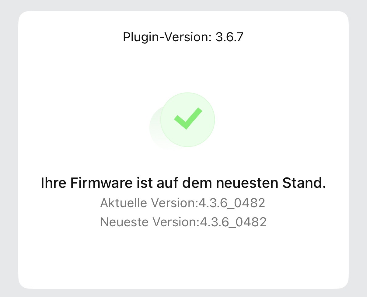

The moower shuts down, every time we try to start it. He made a map of our garden, but does not want to moow anything. As soon as we start moowing, he takes position, gives three beeps and shuts down. It does not matter whether we start it by hand of by app. What can we do or what are we doing wrong?
