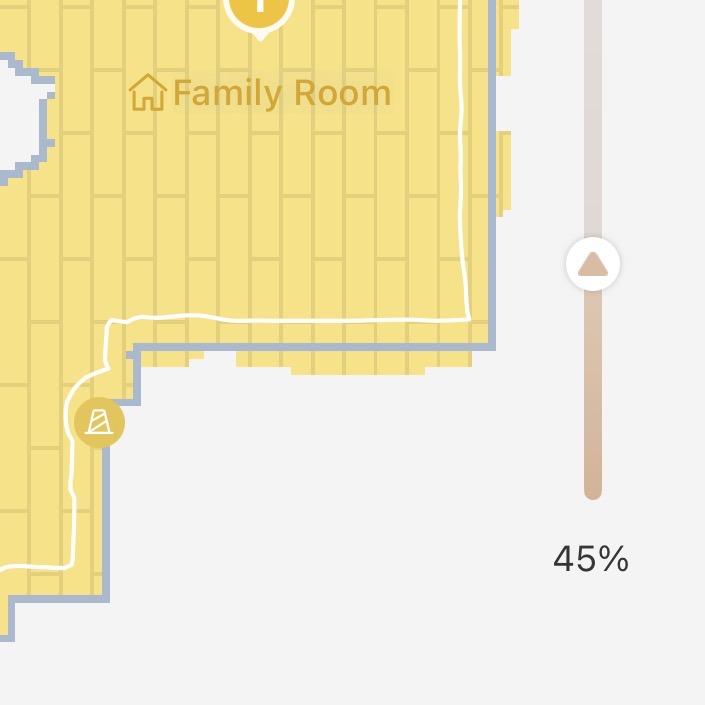

Hi, further to your request, see attached video of my vacuum not cleaning close to the edge of the kitchen plinths. The height of the plinths is 14cm and it is 7cm deep. It does not matter what time of day/night I run a cleaning schedule (currently set to midnight). I have shared the vacuum to your support account as requested. I have also attached a copy of the area on the map as I think it shows what the lidar may be seeing.

Hello cleaning run started at 14:20 UK time. Took 18mins to clean then spent another 9 mins visiting areas it thought were low entry (all around the room, some marked on map, some not, none of them are low entry points) lowered its LDS, but really did not do any cleaning. Raised LDS, moved to different area, repeated until it decided cleaning had finished, hope this helps.
