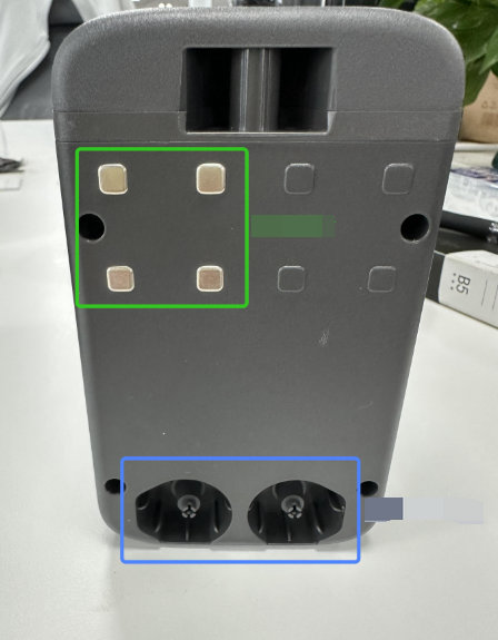

Hello, please remove the dual-compartment cleaning solution box and check if the marked area in the picture is clean. If it is not clean, gently wipe it with a dry cloth and then reinstall the cleaning solution box into the base station, ensuring that it is pushed all the way into the bottom.
Each mop cleaning uses approximately 1.33mL of cleaning solution. The amount used is relatively small, so changes may not be noticeable.
If you clean the mop twice a day, a full box of cleaning solution can last about 4-5 months.

Hello,
The parts you are showing are perfectly clean (as it’s likely that the block is not being used despite the correct settings in the application).
I have been using the device since May 17th, and even though the programmed product quantity is set to be low, after all this time — almost three months — the level should have gone down.
I repeat, blocks A and B are still completely full, right up to the edge.
I made a short video to show that the block slightly pops out when I insert it into its compartment, and I wondered if that could be a possible reason. Unfortunately, I can only attach an image, not a video, and nothing would be visible in a still image.
